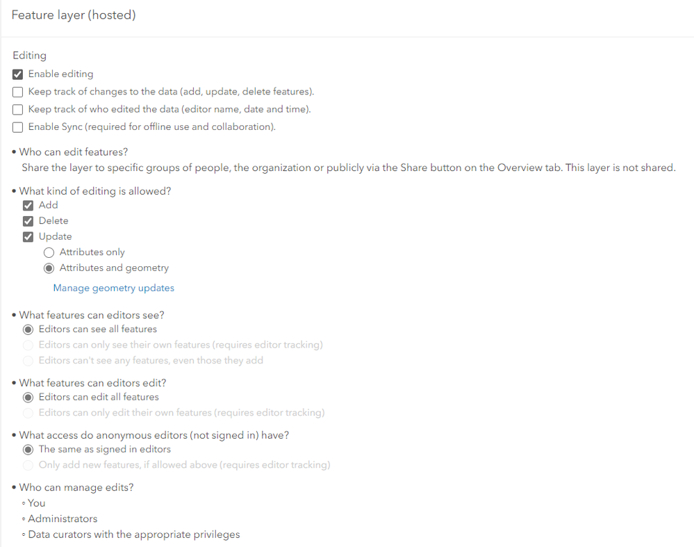

One other thing - double check that the layer supports query. If query is not present on the service capabilities we wont be able to generate the popup.

Pop-ups for the layer continue to not work in the sample. Pop-ups for the other layers continue to work.
I'm not 100% sure how to check if the layer supports query, best I could find from googling is to check the hosted feature layer's editing permissions, which are all set to the highest editing capability level. Screenshot below:

You would see this at the REST level for the service under
Supported Operations:

I am unfamiliar with how to access the REST level, as far I know the layer is hosted on my ArcGIS Online account and I don't see any other settings on the ArcGIS Online page. The layer in question was created in ArcGIS Pro and then transferred to ArcGIS Online via the Publish Web Layer tool if that makes any difference. Prior to yesterday, the pop-ups on this layer were operating correctly. Then, they stopped working for reasons unknown to me.
