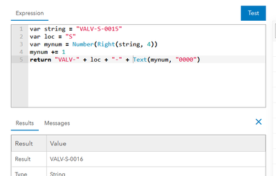

The new "Form" functionality in Map Viewer and Field Maps allows you to have a calculation using Arcade. I've done something similar and I believe my steps were something along the lines of:
  1. Intersect the current feature with your overlay layer, indicating which side of town it's in https://developers.arcgis.com/arcade/function-reference/featureset_functions/#intersects
  2. Get the layer to query itself (filter function https://developers.arcgis.com/arcade/function-reference/featureset_functions/#filter) to find records with an "S" or "N" in the AssetID field, then use Order By (filtered features, "AssetID Desc") to get the one with the highest number at the top, and First(OrderedFeatures) to get the top one
  3. Grab the final four characters of the id by doing Right(FirstFeature.AssetID, 4) , then cast it to a number by using Number(RightFeature)
  4. Get the next number by doing += 1 on the above number
  5. Add the leading zeroes by taking your number and doing Text(mynum, "0000")
  6. Concatenate "VALV-" + the N/S string + "-" + the number with the padded zeroes from the step above
This will then work in that web map or field maps app. Not quite the same as using attribute rules but the best way I've found of doing it in AGOL so far, hope that helps!
