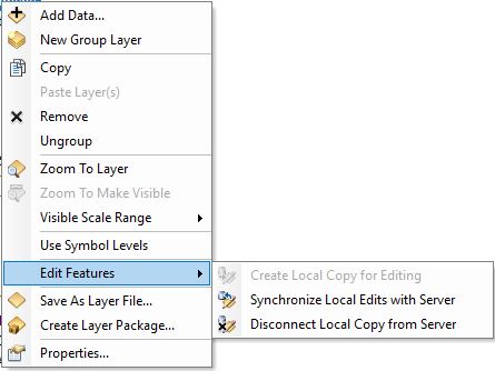

To edit AGOL data in ArcMap:
  • Add the feature service containing the data you want to edit in ArcMap using the "Add Data from ArcGIS Online" option
  • In your Table of Contents, right click on the feature service and select Edit Features > Create Local Copy for Editing
Create Local Copy
  • Edit the data as you would typically in ArcMap, save your edits and quit editing
  • Right click on the feature service again and this time select Edit Features > Synchronize Local Edits with Server

LanceCole
MVP Alum
Anthony Von Moos
Create Local Copy
