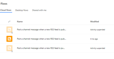

I have this issue too - and Power Automate has now suspended my feeds.  I find this really useful for keeping track of what's new - please fix it!
