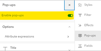

Are you using Map Viewer to set up the map for use in Field Maps? If so, can you check to make sure that pop-ups are enabled for each of the layers that you want to have a pop-up appear on the map?
  1. With the layer selected in the pane on the left,
  2. click Pop-ups on the toolbar on the right
  3. ensure that the Enable pop-ups toggle is switched to on (blue)
