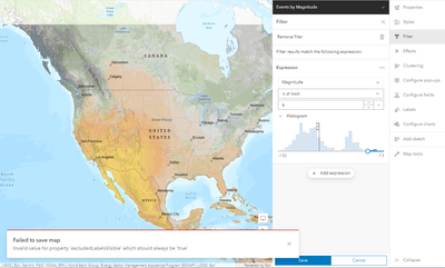

Hi @David_Brooks , @DanielleKulas , we were able to workaround this issue for @gisetc  on Friday. The issue is related to effects that are used as part of filter but not quite clear how it is happening yet. For @gisetc case, enabling feature-specific effects should serve to "reset" this error and get around it. It may work in other cases as well. (should be able to disable it after enabling it and have save work as expected).
Can I ask though, when you save the map, do you happen to have the Filter panel open when actually saving the map (see screenshot below for what that looks like)?? That is the only way we have been able to reproduce it internally (and are looking to include a fix in a patch this week).
Filter panel open when trying to save
Thanks!
