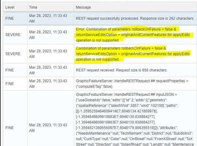

Error is as follows -

I was able to dig into this further, examining the payloads going up, etc....
The difference between the classic viewer, Portal (10.9.1) viewer, and ArcGIS Online's viewer is that the new viewer is adding "returnServiceEditsOption=originalAndCurrentFeatures" to the string that pushes the edits.
For ArcMap published services....no issue. For ArcGIS Pro published services, its an automatic fail w/ the code...
"error":"code":500,"extendedCode":-2147467259,"message":"Unable to complete operation.","details":["Error: Combination of parameters rollbackOnFailure = false & returnServiceEditsOption = originalAndCurrentFeatures for applyEdits operation is not supported."]
The classic viewer does not have it, nor Portal, so I am assuming it was the recent updates to the viewer which causing the issues.
