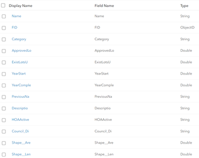

dwold
@ChristopherCounsell Attached is my CSV. Hosted Layer schema:

It doesn't look like this csv layer can be appended to this Hosted Feature Layer for a few reasons:
  • I believe a spatial input is required (x,y fields for a point)
  • Don't imagine globalids are preserved here
  • Editor tracking fields are system-set, you can't define them (creationdate,editor,editdate etc)
From what @DanPatterson  said it also sounds like you have a different goal to 'append', where maybe instead you are looking to 'update' features?
Probably better to phrase your question as "I have this data, and want to do this workflow, what methods are available" rather than hit an error and focus on that. For example, we may be able to recommend Pro or other tools/workflows to better assist what you are doing.
