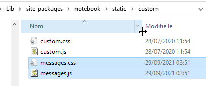

MohandKETTOUCHE
Alternative that work for me :
Copy 2 files (messages.css & messages.js)
from directory :
C:\Program Files\ArcGIS\Pro\bin\Python\envs\arcgispro-py3\share\jupyter\kernels\ArcGISPro\default
To Jupyter Customizing directory (it look like this in windows) :
C:\Users\YourUsername\Anaconda3\Lib\site-packages\notebook\static\custom
restarting jupyter notebook.
