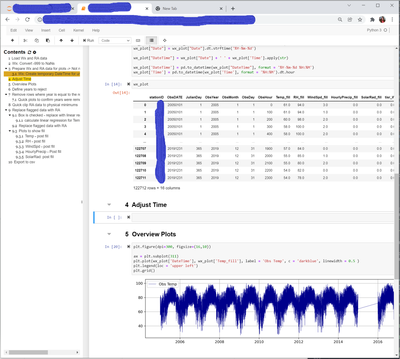

I'm having the same issue! I subscribed to the bug report Kory linked. But I'd like to add that in addition to the menu bar, logo, and notebook name missing, code cells,  output dataframes and plots are truncated on the right hand side of the screen without the ability to scroll right/left to view the entire thing. Anyone else having that issue? I also noticed that when I open a notebook in a web browser, everything looks normal while the kernel is loading, then once the kernel has loaded the view changes and the menus go missing, plots are truncated, etc. Here is a screenshot of what my browser looks like. Hope that helps the bug report move along quickly because the work around suggested previously isn't working for me unfortunately.
