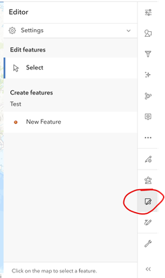

You can click the Edit button on the right side of the screen and that will allow you to edit records with editing enabled.
RyanUthoff
MVP Regular Contributor
If editing is disabled on the layer in the map, you can enable editing in the layer properties. Open the properties of the layer which and enable editing.

EmilyGeo
Hi @AndyKubrin
It looks like you may be using a layer that does not have editing enabled.
Either the layer owner or an organization administrator can enable editing on the layer.
When editing is enabled, then you'll see the Edit button on the light toolbar on the right.
