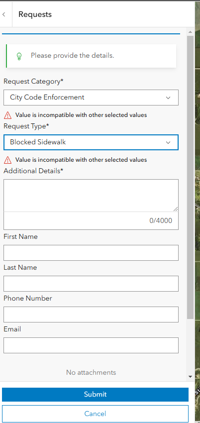

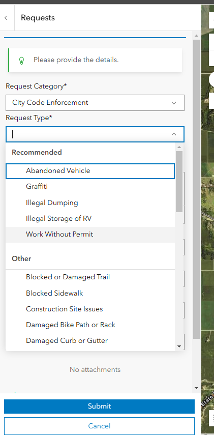

I have been working on setting up the AGOL Citizen Problem Reporter V3 for our community.  One issue I'm running into is the 'Request Type' drop-down menu on the Problem Reporter Instant App, is displaying two categories with request types to choose from:
Recommended- which are the actual request types that are associated with the selected Request Category
Other- which is a list of all the request types within the CSV file that the data is pulling from.  If you select a request type from the 'other' category, you get an error that the "Value is incompatible with other selected values"
Is there a way to remove the Other category and only show Request Types that are associated with the selected Request Category?  I've tried to manipulate the Request Types Notebook and add an Arcade Expression to the Request Type Form within the Map with no success.
Thank you!
