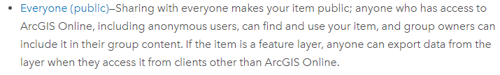

Our Clerks department would like a workflow that lets members of the public add their name to a Permanent Absentee Voter list. We'll be using Geocortex for the workflow, but we're still looking at the best way to host the data.
A public user should be able to create a record with their name, address etc. But we don't want this data publicly available and we don't want anyone to be able to access/download it/add it to a webmap using Add Layers. Right now it doesn't seem like this is possible due to the definition of sharing with "Everyone":
But then I found a post that says if you mark a hosted layer as "Editors can't see items, even those they edit..." or something similar, and also the Citizen Problem Reporter. Can anyone confirm that it's possible to make a hosted layer publicly editable, but NOT available to the public or anyone outside of the group we designate?
