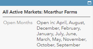

I have a web map on ArcGIS Online that pulls it's data from a REST service. The REST service shows active farmers markets for my state and it lists what months each market is open in an extremely cumbersome fashion. The attached screen shot shows that each market has a YES or NO value listed 12 different times for a single market inside it's pop-up window. I want to consolidate all of these YES and NO values into a new feature that simply states what months the market is open.
This is the pop-up for this market as seen through a dashboard, which will be the final application of this map.
I just want the pop-up to state something along the lines of "Open in: Jun, July, August, September" for each market you click.

by Anonymous User
Not applicable
You're a wizard! It worked perfectly besides listing a couple months in the wrong order, but I can manage fixing that myself I think.
One more piece of help please! It lists the months in alphabetical order instead of by the order of months in a year. I try and type some solutions to this into your code but I can't seem to do anything other than break it. What to do? @XanderBakker

by Anonymous User
Not applicable
@XanderBakker,
As of now, it's unchanged from your original expression you replied with. I was just poking around trying to find a solution by trying different data functions but to no avail. I apologize for any confusion; this is my first time ever asking for coding help of any type so perhaps my ability to correctly frame the problem is somewhat handicapped.
To clarify, your code worked wonders in displaying the months in a concise manner as I wanted. The only problem is the script defaulted to sorting the months by alphabetical order and I would like to have them displayed in the ordinary order for months. (i.e. January, February, March April, December instead of April, December, February, January, March)
XanderBakker
Esri Esteemed Contributor
Hi @Anonymous User ,
I just posted a workaround and I also noticed that the order of the dictionary is alphabetically and not the order as one defines it.
by Anonymous User
Not applicable
@XanderBakker
Indeed you did! I guess I should have refreshed my page sooner to see your response, whoops. Your simple workaround worked perfectly with no issues; the months display in the correct order. Thanks again for the help! I look forward to going through the resources you linked to.
