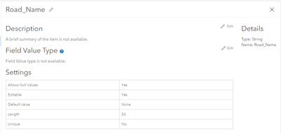

Is it possible to constrain AGOL feature layer edits to a single attribute field? I've been searching for a way to allow a coworkers to populate a flag field in a line feature layer. Editing in map viewer does not seem intuitive and comes with the risk of someone editing the wrong attribute field. It takes quite a few clicks to get into the editing menu (...more -> Edit -> Edit feature -> select feature) and once there my configured pop-ups are not honoured so 20+ attributes can be edited with the flag field listed at the very bottom of the scrolling window.

You can change the per-field editing settings on the Data tab. Just set "editable" to "No" on the fields you don't want changed.

SarahHartholt
Thank you! Works perfectly.
There is one attribute that I cannot change this setting on though. Is there a reason for this?

Perhaps that is the "display field" for the layer? You might have to look deeper into the service's properties for more information.
