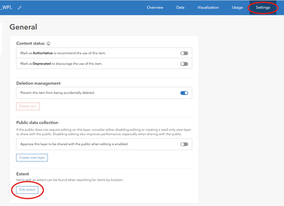

I know this is old but I just stumbled across this post while looking for something else. Have you tried going to the settings page and clicking "Edit extent" from there, rather than the visualization tab?
