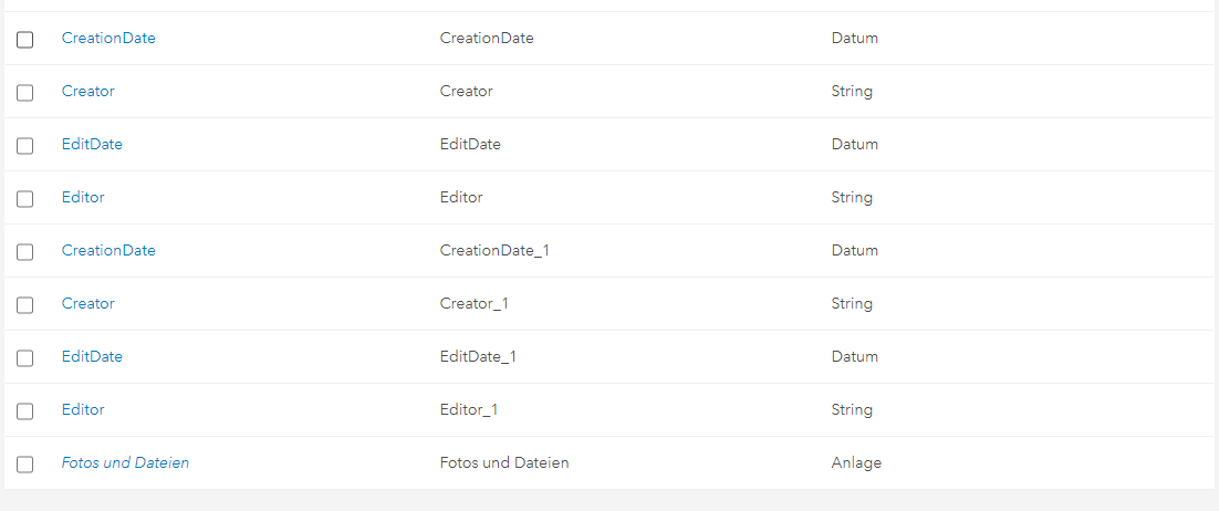

I'm using an AGOL hosted feature layer and several views of it in an Instant App and in AGOL Field Maps with online and offline data collection. I also collected Creator and Editor information.
At one point I had to export the layer from AGOL into ArcGIS Pro to update some Contingent Values and Field Groups. I kept the Creator etc. information and used "overwrite existing service" to publish the data to the same service.
Instead of using the existing Creator columns, AGOL created new ones (Creator_1 etc.):
Is there any way to avoid this problem and at the same time keep the existing Creator etc. information?

AdminWPZ
Hi Richard, thank you so much for the link. This has worked out perfectly. I wasn't aware that you can edit Tracking fields by hand after disabling Editor Tracking.
