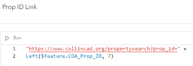

I created an expression with Arcade to go to a hyperlink with a 7 digit code that pulls from a field.
My question is how do I change the Text for the hyperlink?
The default is 'View', but I'd like to display that 7 digit code from my field. I added this expression into the 'Fields List' in the pop-up configurations.
Apologies if this question has been answered. I'm very new to Arcade and most posts about hyperlinking from the Text option for Pop-Up content.

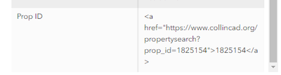

LaurenLumHee
jcarlson
MVP Alum
Don't put it in a field list. Your popup should let you add an Arcade element.
