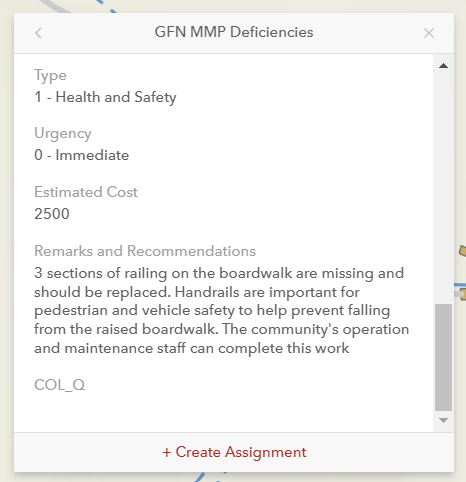

This is a snip from the layer that I want to pull information from for the email.
