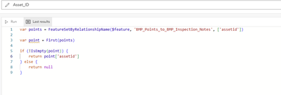

AmandaHoffman1
I have been trying to add an asset ID to my related table from the parent feature. I tried some of the other solutions listed and still have not been able to get the field to populate.
My goal is to have the Asset ID auto populate in the Field Maps form when a new inspection is being added to the point. I wrote this expression based on this the esri example.

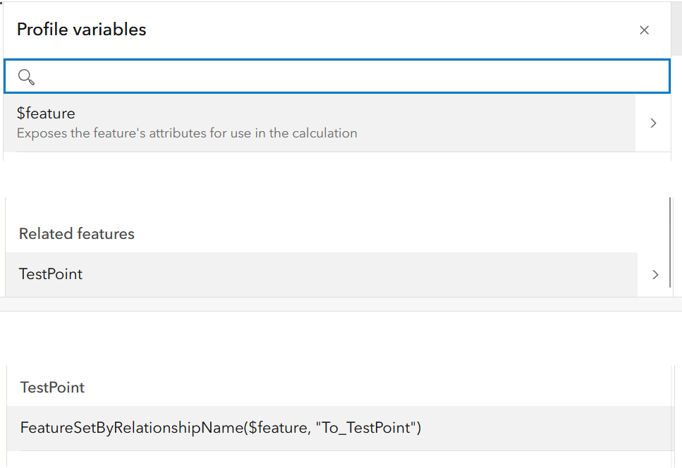

AdamAull
Hi Amanda.
The issue you are having caused me to attempt this on my own. I created a feature class with related table, published the service to my Portal and created the Arcade expression. I was able to successfully populate the related table pointID field from the origin table using the code below.
I added the FeatureSetByRelationshipName on line 2 directly from the Profile Variables list to ensure the correct spelling of the backwards relate name.
-Adam
// Get the feature set for the hydrants
var hydrants = FeatureSetByRelationshipName($feature, "To_TestPoint", ['pointID'], true)
// Get the first hydrant (should only be one)
var hydrant = First(hydrants)
// If there was a hydrant, return the facilityid of it,
// Otherwise, return null
if (!IsEmpty(hydrant)) {
    return hydrant['pointID']
} else {
    return null
AdamAull
Continued testing, and found that FieldMaps indeed does not add the pointID to the related table. Appears that FieldMaps will not honor the Arcade expression. The image shows “Failed to calculate” on the field. I believe this to be a bug in FieldMaps.
