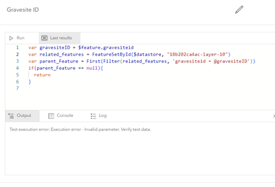

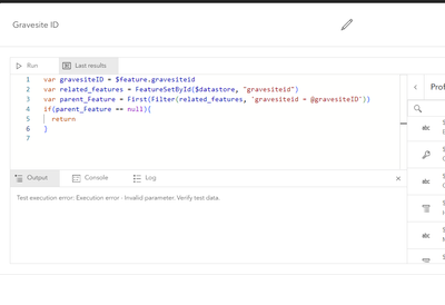

I am looking to populate the gravesiteid field from the parent into the gravesite id field in the related table, but running into issues
Could anyone write out what goes where?

I would get the same error because I was not referencing the correct layer_id from the map.
Are you sure your layer_id is "gravesiteid"?  From my limited experience it is usually not that descriptive.
For ex. a layer_id in one of my maps for a Road layer named "Roads" is "18cf513418f-layer-3".
The only way I have found so far to get a layer_id without using code is to use ArcGIS Assistant to view the JSON of the web map.

I tried putting some #s in, but still get an error. I am very new to this so I guess I'm confused on what it is asking for.

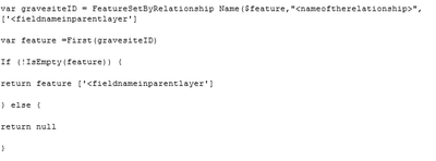

Update:
This is what ended up working for me

Issue might be in your third line for the filter.  You have it filtering to 'gravesiteid = @gravesiteID'
I think it should be 'gravesiteid=' + gravesiteID.
Here is the code I am using that is working.  In the featuresetbyid I am adding a third parameter to just grab the specific field.
var join_ID = $feature.ID
var fs_prevprojyear = FeatureSetById($map, "18cf513418f-layer-3", ['Project_Ye'])
var filter_relate_feature = First(Filter(fs_prevprojyear, 'ID=' + join_ID))
return filter_relate_feature.Project_Ye
