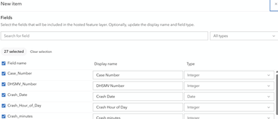

Actually, yes, that will work. Just download the data as a csv, and then upload the csv to AGOL. From there, you'll get to a page that looks like this:

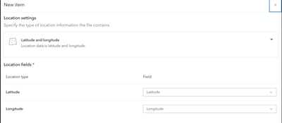

You can modify that as necessary. And then when you click next, you'll get to this page where you can specify the lat/lon from the columns in the spreadsheet.
After you do that, it should create a new layer in AGOL with the spatial locations of all the records.

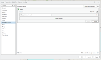

Could be anything. Here's two things that pop into my head since I can't see your project. Could be there is a Definition Query set to show only certain fields and then forgot about. Right click layer properties > Definition Query.

I'm sorry, I can't figure out how to get to the menu that you are showing. I really wish I could share a screencap here, because none of what I see looks like your screen caps!
I have no "layer properties" in my view to right-click on. I can drop down a menu from the "..." next to the layer in the Layers list, and select "show properties," but it just opens a bar at the right side of the map with expandable boxes for information, symbology, appearance, visibility, editing, refresh interval, and feature display order. Under "information," there is a button to "manage layer properties," but clicking on it just gives a message, "all properties are stored in source layer" with options to reset to source layer or disconnect layer properties. I don't see a "definition query" anywhere in the assortment of boxes.
BrantleeSR
BINGO! Uploading from CSV worked.

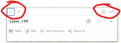

One more question: you noticed that the points were all on top of each other in the original geojson upload. How do you see points under other points in an ArcGIS map? Can an area be selected to show the number of points stacked on top of each other?

In an ArcGIS Online web map, you can see if they're on top of each by clicking on one of the points. In the pop-up, you will see arrow icons where you're able to switch to view the attributes of other records. So in the case of my example screenshot below, there are two records on top of each other. And you're able to change the pop-up to view the attributes of the other records on top of each other by clicking the arrow button.
