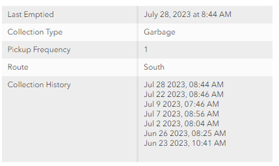

ArmstKP
@MelissaSalich You can definitely create an Arcade expression to show related records in the feature's popup.
You could also write an Arcade expression for symbology.  If there is a Hydrant Inspection, return this symbol.  If there is a Valve Inspection, return this symbol.  If there is both, return this symbol.....
