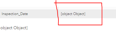

Hello,
I have this code and I getting result in test but I can't set it up in pop-up of new map viewer?
var intersectLayer =Top(OrderBy(FeatureSetByName($map,"xyz"),"Inspection_Date DES"), 3);
return intersectLayer
and this is I am seeing on pop-up

intersectLayer is a FeatureSet. It will be shown in the expression builder's test, but popups can't show it.
You have to build a string:
var inspection_dates = []
for(var f in intersectLayer) {
    Push(inspection_dates, f.Inspection_Date)
return Concatenate(inspection_dates, TextFormatting.NewLine)
Have a great day!
