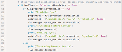

        # If no views and disableSync is True: disable Sync, truncate, and then re-enable Sync.  OBJECTIDs will reset
        elif hasViews == False and disableSync == True:
            if flc.properties.syncEnabled == True:
                print("Disabling Sync")
                properties = flc.properties.capabilities
                updateDict = {"capabilities": "Query", "syncEnabled": False}
                flc.manager.update_definition(updateDict)
                print("Truncating Feature Service")
                fLyr.manager.truncate()
                print("Enabling Sync")
                updateDict = {"capabilities": properties, "syncEnabled": True}

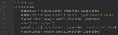

ModernElectric
@JakeSkinner
I am using one of your previous scripts to update a single Hosted Feature Layer. Part of the script disables the sync feature on the FL in AGOL.
How do I go about re-enabling the sync at the end of the script? Without the FL having Sync Enabled, it is giving our Workforce Project(s) real problems with the layers.
Appreciate your help as always
JakeSkinner
Esri Esteemed Contributor
@ModernElectric,
The script should disable and re-enable Sync in this portion of the script:
Sounds like this is not happening on your end?

JakeSkinner
@ModernElectric try the latest script here.  I updated the code to re-enable sync on the feature service if it was previously enabled:
ModernElectric
@JakeSkinner
Good to go again. Appreciate this.
Verified the Hosted Feature Layer had the Sync re-enabled after the script was ran. Also, shows the modified date was also updated in AGOL.
Exactly what was needed.

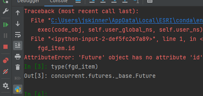

@BrianShepard good find.  I think there are still some issues.  The help states this should return arcgis.gis.Item, but during my testing it's returning concurrent.futures._base.Future.  Which will cause the append operation to fail:
BrianShepard
@JakeSkinner I modified one of my production scripts with:
# Upload zipped File Geodatabase
print("Uploading File Geodatabase")
fgd_properties={'title':gdbId, 'tags':'temp file geodatabase', 'type':'File Geodatabase'}
#fgd_item = gis.content.add(item_properties=fgd_properties, data=gdb + ".zip")
root_folder = gis.content.folders.get()
fgd_item = root_folder.add(item_properties=fgd_properties, file=gdb + ".zip").result()
Both add methods upload a zipped fgdb to my Home folder in AGO. The rest of the script ran as expected and my target Hosted Feature Layer has the expected number of features after append...it didn't appear to fail.
It seems to be working aside from getting a warning about my local .zip file being unclosed:
C:\Program Files\ArcGIS\bin\Python\envs\arcgispro-py3\Lib\concurrent\futures\thread.py:58: ResourceWarning: unclosed file <_io.BufferedReader name='T:\\General Eng\\GIS\\ArcGIS Pro Projects\\Tax Lots\\scratch\\664ba992-b1bc-11ef-a21f-b07b2506e44a.gdb.zip'>
  result = self.fn(*self.args, **self.kwargs)
ResourceWarning: Enable tracemalloc to get the object allocation traceback
JakeSkinner
@BrianShepard thank you for posting your code snippet.  I was missing the .result() for the add method.  I've updated the script and zip file on this page.

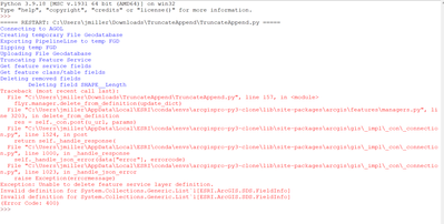

Hi @JakeSkinner, this script has been working for me, but I have a large dataset that it fails on. I works on my smaller datasets, but fails on our Parcel Layer that is over 200,000 features. The only error I get is the "Error code 500: Unknown Error" after the feature deletion phase and during the appending phase. I believe it happens on the . I have tried using the upsert method, but I get this error:
Unable to add feature service layer definition.
Invalid definition for System.Collections.Generic.List`1[ESRI.ArcGIS.SDS.FieldIndex]
(Error Code: 400)
Can you provide any assistance? I can invite you to a AGOL group if you have time to assist.

@cartolizard looks like the feature service is empty.  Could you append data to the service (you can try using ArcGIS Pro's Append), or overwrite the service?
cartolizard
New Explorer
@JakeSkinner You can disregard my issue. Turns out the problem was a schema change from the source table. 10 digit zip codes were added to a field, but the character limit for the field in AGOL was 9.
