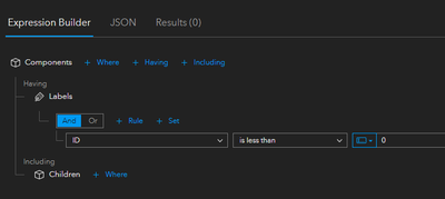

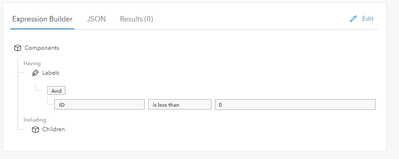

To clarify, if you create collection with "including children", as below, any new service will be automatically added this to collection with no label.  If you still need "no label" collection, here is one way:

Hello @AndrewSakowicz , I created the above collection using the same parameters as yours but it does not give the components that do not have labels. I have many service components that are missing labels but they do not get added to the collection.
Could you please suggest a way to find components that do not have labels?

Thank you for your feedback and following up.  I tested and indeed "is not" or "is less than" does return expected results.  A bug issue is opened.  We'll keep you posted.
