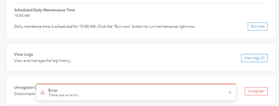

Tried that and it wasn't very helpful.
Dev console comes back with
https://xxxxxxxx:30443/arcgis/admin/database/run 500 (Internal Server Error)
