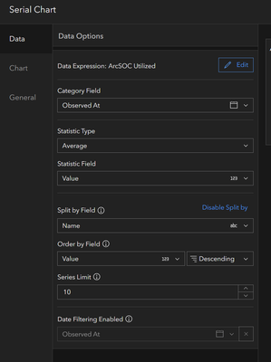

This is the expression I use to get a total number of ArcSOCs running and then displaying it in a chart (we have multiple servers so we select multiple "ID" and split by the name field to we can see the number of ArcSOCs per machine. If you only have one machine, you'd only select your one machine).

Hi Rayan,
Thanks for your post, but I am not seeing any
Observed At in Category Field
And no Value in Statistic Field
! (second image) and the chart is always empty

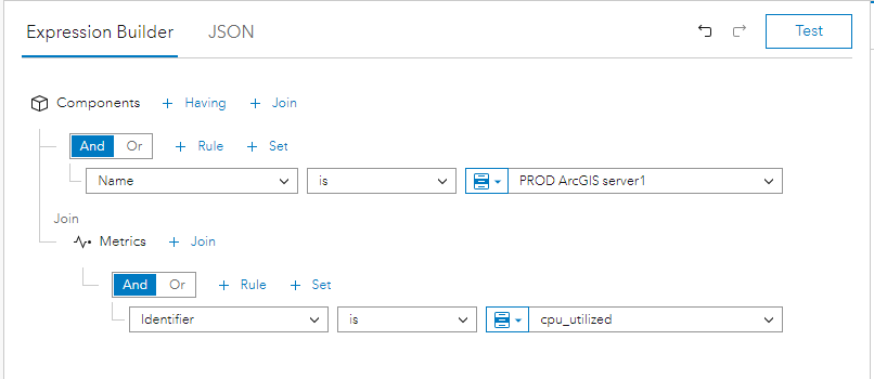

Hi @RyanUthoff , @BHK and/or @Dan_Brumm  - I am in the same position as well. I also do not have an Observed At for a Category and do not see a Value for the Statistic field.
Does anyone out there have a working example of this? Or point us in to a resource?  @DerekLaw ?

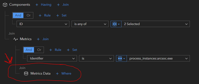

BHK
Hi David,
In my case the trick was missing the last join of Metrics Data to the Metrics
after updating the expression I got everything up and running

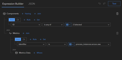

RyanUthoff
MVP Regular Contributor
And you also need to set your component to the Windows Host component, not the ArcGIS Server component (at least that's how I have mine configured).

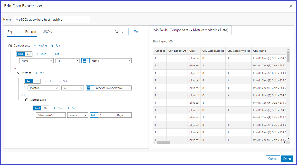

Hi @DavidColey,
To query for the number of ArcSOCs running on a host, you can use this data expression:
The Identifier field is "process_instances:arcsoc.exe".
Then you could use the same serial chart configuration that @RyanUthoff mentioned in his post.
