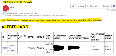

However, I should mention that, in my case, the triggers are not firing the same way as they did before the upgrade. Here’s how it appears in my system:
