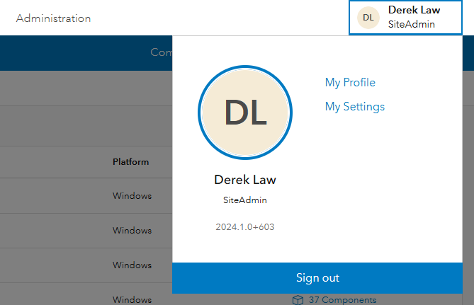

FYI: You can check the release version of ArcGIS Monitor by clicking your profile in the upper right corner of the web app,
