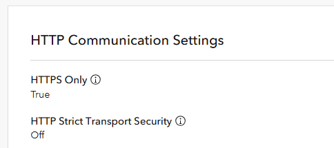

Hi @Martijnde_Boer,
Can you please check the HTTP communication settings in ArcGIS Monitor? Please navigate to Administration page > Server subtab > HTTP communication settings.
  • Is the HTTPS Only property enabled?
  • Is the HTTP Strict Transport Security option enabled?
Please see this help topic, Enforce strict HTTPS communication
does anyone know when BUG-000174232 will be fixed?
It looks like this was submitted on 2/11/2025 and is still being reviewed by Tech Support.
Hope this helps,
Martijnde_Boer
The HTTPS Only has been set to False because the remote stand-alone arcgis servers (without a web-adapter)  are set to HTTP only for protocol (in home>security>config)
And we want arcgis monitor to work with HTTP only
