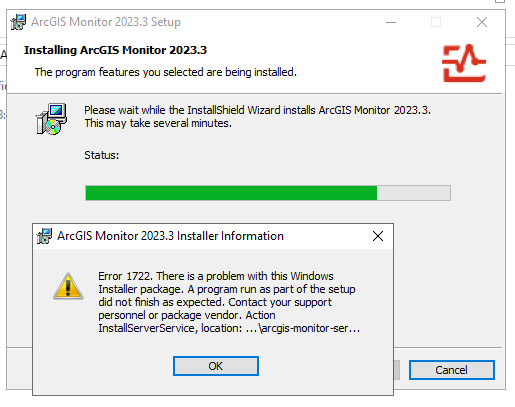

Hello everyone. I am trying to install ArcGIS Monitor 2023.3 using gMSA and I am getting the same installation error 1772. I suspect it is related to the issue discussed here. Could someone please share with me the fix/workaround? Please and thank you.
DerekLaw
Esri Esteemed Contributor
Hi @Mike_Tulis,
I just replied back to your email regarding your post.
Hope it helps,

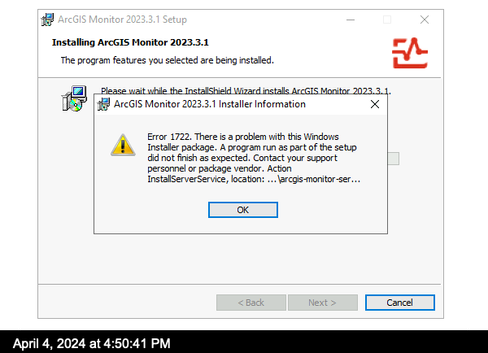

This is still an issue at Monitor 2023.3.1, @DerekLaw. My domain-level service account has a single underscore in it, password has no special characters. I got this error:
My workaround was to install with a local account and password with no special characters, then post-install, in the Monitor Windows service, change the log on user to my domain account.

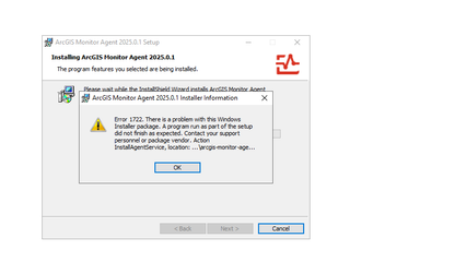

Hello @DerekLaw and @GeoJosh I found this article as I have encountered the following error when installing the ArcGIS Monitor 2025.0.1 Agent to our Enterprise machine:
I install it through the gMSA account that runs ArcGIS Monitor Server and Agent on the Monitor VM. These work just fine.
I do not think it is BUG-000159608 since the Agent is successfully running under the same Service Account on a different machine. Perhaps I need to check something on our Enterprise machine regarding this gMSA? Any insight is appreciated. Again, this is a fresh install.
I run the installer as an Admin but wanted to circle back to this conversation on gMSA accounts and special characters? Thinking about logging a ticket with Esri Support but wanted to try here first.
GeoJosh
Hi @katelynjenk,
This is strange, I have not seen this behavior with the 2025.0.1 release. I think the best course of action is to log a case with Support to troubleshoot further. The fact that this is occurring on one machine but not others points to an environmental / configuration issue on the machine itself, which Support should be equipped to help narrow down.
Josh
