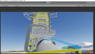

Hi,
is there an easy way to get the colors of the objects. In the attached picture you see the colored model in the map viewer, but in unity the same model has no colors.
Please help, i need the colors in Unity. Textures are displayed normaly.
Thank you!
Greets
Ingmar
PS: and the correct model names would be nice too.

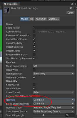

Hello, I also had that problem. But only when i direct drag assets in the Hierarchy window. Before i dragged it i go to the Inspector and change there the Normals to Calculate and then i got the colors.
The problem also can be that you don't have the latest version of the ArcGIS SDK plugin or that the 3D Object Scene layer from ArcGIS is a older version. Share it again as Web Layer and use ArcGIS Pro 3.0
