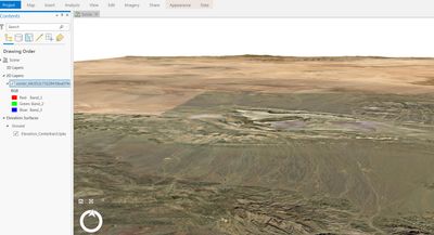

i have problem with offline data.
sdk show elevation tile(tpkx) but dont show image tile package.
these package have two different extent. but show elevation and image package in arc pro without problem

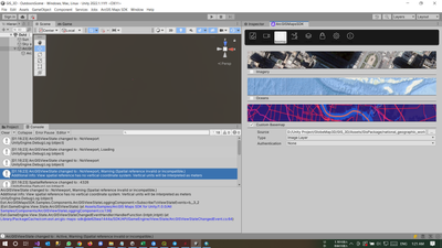

view state error is :
ArcGISViewState changed to : NoViewport, Error (Unknown error.)
Additional info: provided uri is invalid: D:/Unity Project/GlobeMap3D/GIS_3D/Assets/GisPackage/national_geographic_world_map_tpk_9f42193c50544b39ba848365be579e54.tpk
UnityEngine.Debug:Log (object)
Esri.ArcGISMapsSDK.Samples.Components.ArcGISViewStateLoggingComponent:<SubscribeToViewStateEvents>b__3_2 (Esri.GameEngine.View.State.ArcGISViewState) (at Assets/Samples/ArcGIS Maps SDK for Unity/1.0.0/All Samples/Components/ArcGISViewStateLoggingComponent.cs:136)

Do the samples we ship with the plugin work? We are on 2021 right now but I would guess 2022 would be fine, you should just test it with the ones we ship. Looks like there is something wrong with the filepath acording to the log

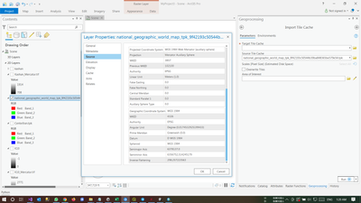

i change basemap to image layer then error is changed.
i use web mercatur coordinate system for 2 tile and elevation package. but error is :
ArcGISViewState changed to : NoViewport, Warning (Spatial reference invalid or incompatible.)
Additional info: View spatial reference has no vertical coordinate system. Vertical units will be interpreted as meters
