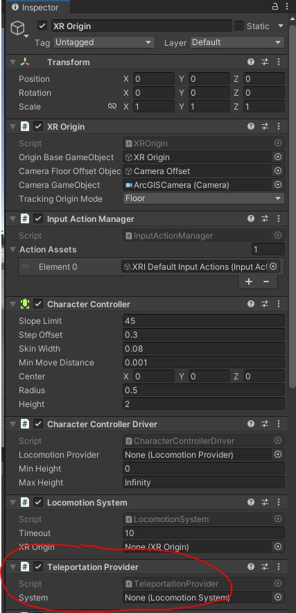

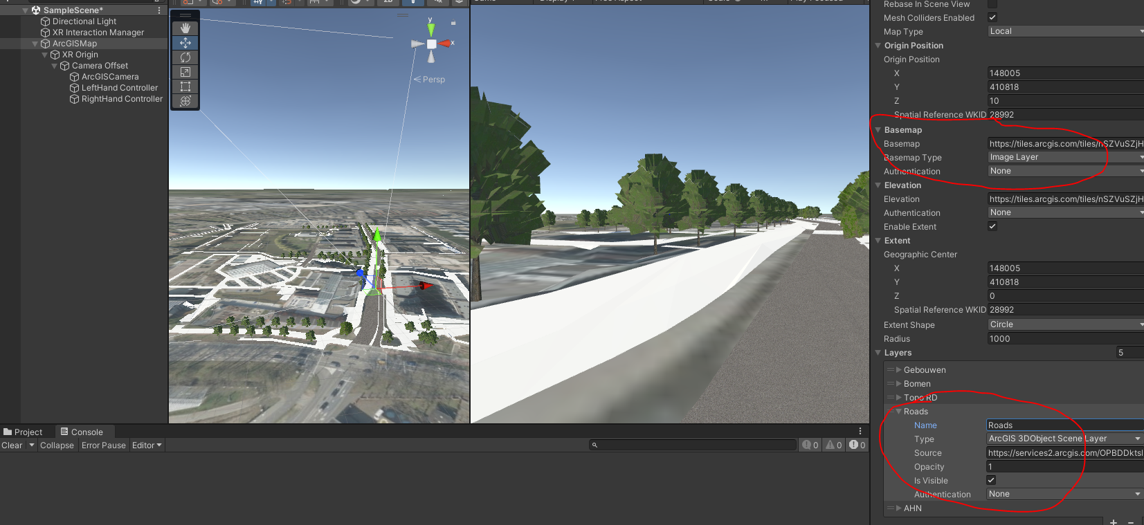

Hello,
I have a question. I can turn my head in the Oculus Quest 2 and i can look around the city. I can also Continous move over the Basemap with the dumpstick of the controller but now i trying to make a teleport area on the basemap or the roads layer so that i can jump to locations ((continous move is slow:)). I have set a teleport provider on the XR Origin and often you can add the teleport area component at a gameobject that has a collider with the result you can jump on it. But the Basemap and Road layer are game objects?

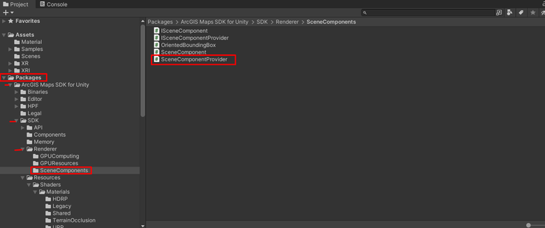

m_d
Thanks for the solution and code. It works, though agreed--is pretty dirty. Still.
With the new v1.1.0 SDK, the file to modify seems to now be Esri.ArcGISMapsSDK.Renderer.Renderables.RenderableProvider.

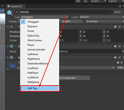

IngmarWittmann
You just need to insert the line of code(red Arrow in the Picture above) in the SceneComponentProvider Script this will tag all ArcGis Gameobjects with the Tag"ArcGis". Then you need to add this Tag in the Unity Editor.
the "findobject" Script from above  just put it on an empty gameobject in the scene.
