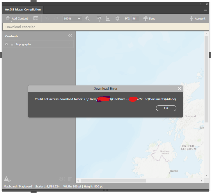

Hi just upgraded to the new 2024 Illustrator and the 3.6.0 plugin and am now getting the following error when trying to sync a map into illustrator. Any ideas?
Many thanks

Anna_Breton
Hey there @AdamBushnell
After a bit more digging, it looks like the issue you're seeing may be related to your download folder naming convention. How fun!
If we look at the screenshot you shared above, you'll notice a "%2c" after OneDrive - in your download folder URL. This indicates that there may be a comma in your OneDrive folder name...and commas (and other special characters) can break things 😀
If you can change the name of your OneDrive folder to not contain any special characters, such as commas, your issue should be resolved.
To change the name of your folder you can try right clicking your OneDrive folder location, go to properties, and you can edit the name of your folder there. If you complete those steps but don't have access to make name edits, you may have to disconnect your OneDrive account. After you unlink your account, then you can go to properties and edit the name of the folder, and then re-link your OneDrive.
Here are some steps to help with that process if needed
If we can get rid of that comma, you should be able to sync maps with no issues.
Let me know if this helps!
-Anna
AdamBushnell
Hi Anna,
Thanks for all the help so far
I'm afraid that option won't work - my organisation's oneDrive location is pre-named and can't be changed. From a bit of goggling it seems that Microsoft will use the naming convention for all enterprise clients with that comma.
Nothing has changed apart from the illustrator 2024 and arcgis extension 3.6 upgrade.
