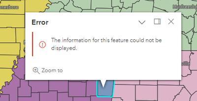

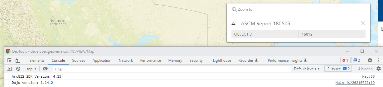

Hello,
I'm looking at updating to the latest SDK version 4.26 but getting error with the popupTemplate.content property and found that it started in 4.16.  Is there something that I would need to change in 4.16 to fix that error?
In 4.15 no issue, the popup template loads.
Then with 4.16 it doesn't load the content, just the title.

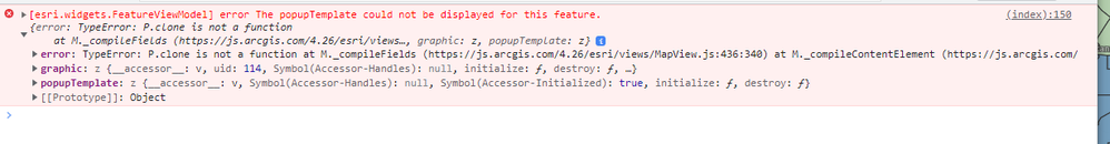

YimYean
Was able to re-use the popup template function example code and updated to return the content array to show that the issue is reproducible.  In below example it's using latest 4.26 SDK.

UndralBatsukh
Hi there,
It looks like you can no longer autocast the FieldsContent object. If you update your code to create and return a new instance of this class then the popup should/will work. I tested it quickly and in my test the following works.

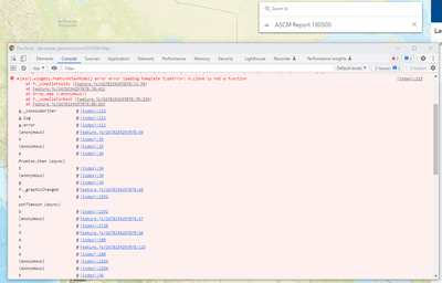

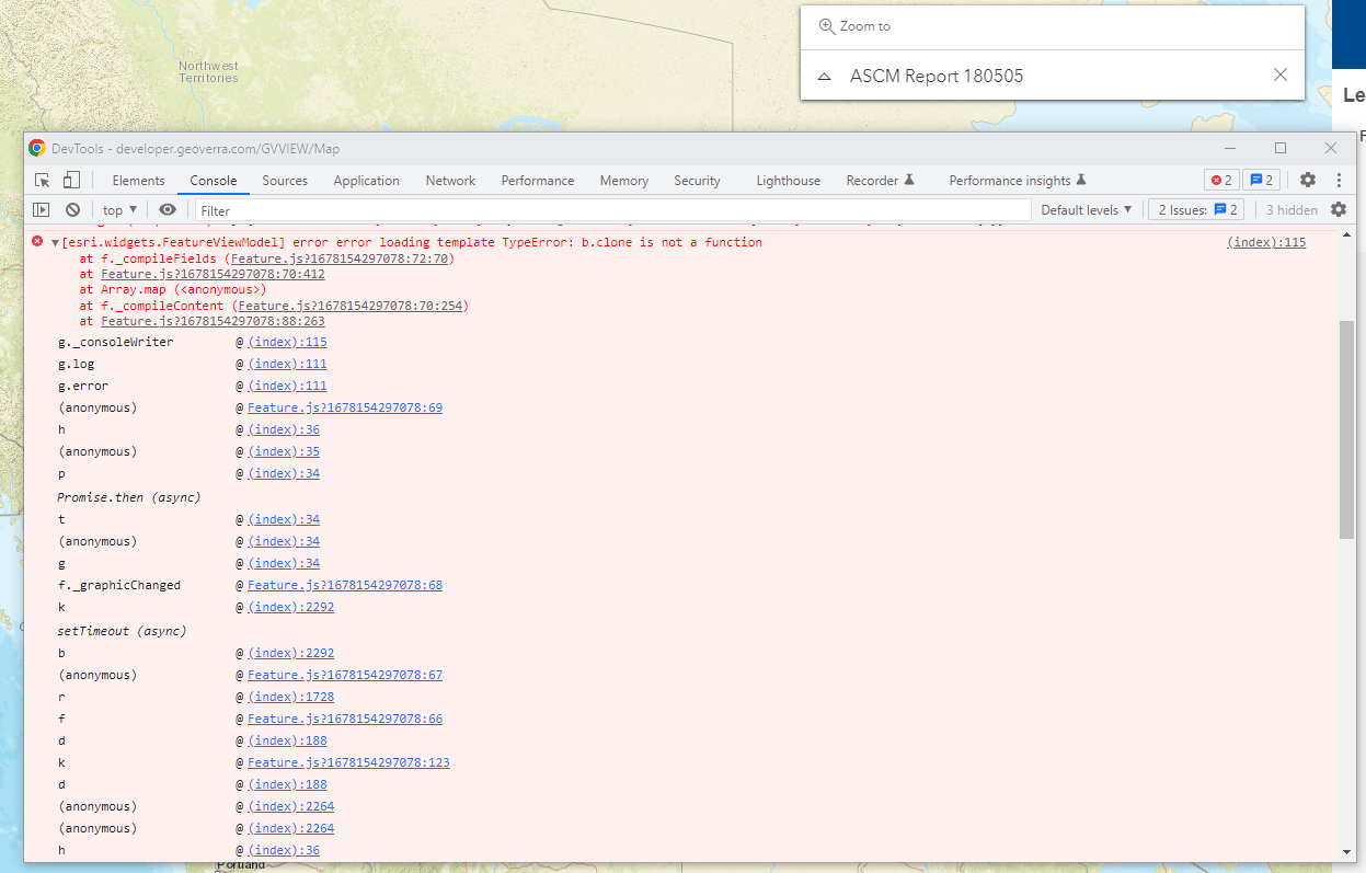

YimYean
Hi @UndralBatsukh ,
I tried the update and the console error and popup no longer gives an error but the fields aren't loading.  Are you able to provide the full sample in case I'm missing anything.

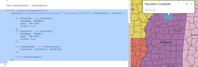

From my full sample code above I made the following update.
          function populationChange(feature) {
              require(["esri/popup/content/FieldsContent", "esri/popup/FieldInfo"], (FieldsContent, FieldInfo) => {
                  let fieldInfo1 = new FieldInfo({
                      fieldName: "POP2010",
                      label: "POP 2010",
                      visible: true
                  let fieldInfo2 = new FieldInfo({
                      fieldName: "POP2013",
                      label: "POP 2013",
                      visible: true
                  let fieldsElement = new FieldsContent({
                      fieldInfos: [fieldInfo1, fieldInfo2]
                  return [fieldsElement];
But the fields aren't displayed.

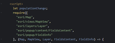

UndralBatsukh
It is working for me. Here is a codepen shows it working: https://codepen.io/U_B_U/pen/JjarRyY?editors=1000
YimYean
Thanks, looks like my method of importing the required FiedsContent and FieldInfo didn't work when it was used within the populationChange function.  But once I moved it to the top as in your example that resolved the issue.
