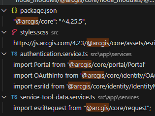

I have created an Angular application where I use a small amount of ArcGIS Maps SDK for Javascript.
But when I build the application it looks like all of the ArcGIS Maps SDK for Javascript modules are bundled with my application.
This is what I use (for now).

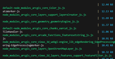

And here is a small part of the modules that are bundled with the application.
I probably miss a setting somewhere, but I do not know where to look.
//Robert
AndyGup
Hi Robert, there is information on the build bundles here: https://github.com/Esri/jsapi-resources/tree/main/esm-samples#bundle-size-and-performance.
