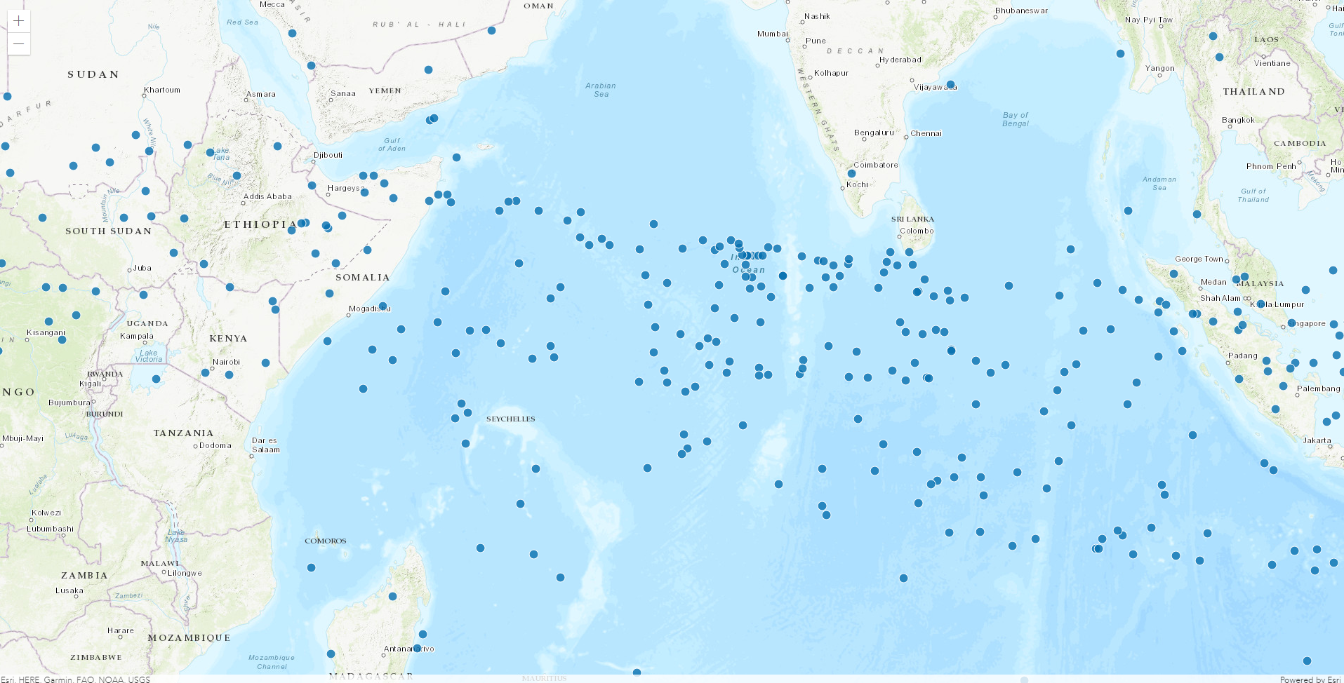

I test with this web map: https://webmaps.maps.arcgis.com/home/webmap/viewer.html?webmap=f03cb753b3384bd8a3dd36ed2c4958d4
And when I open this web map it looks like below.
