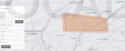

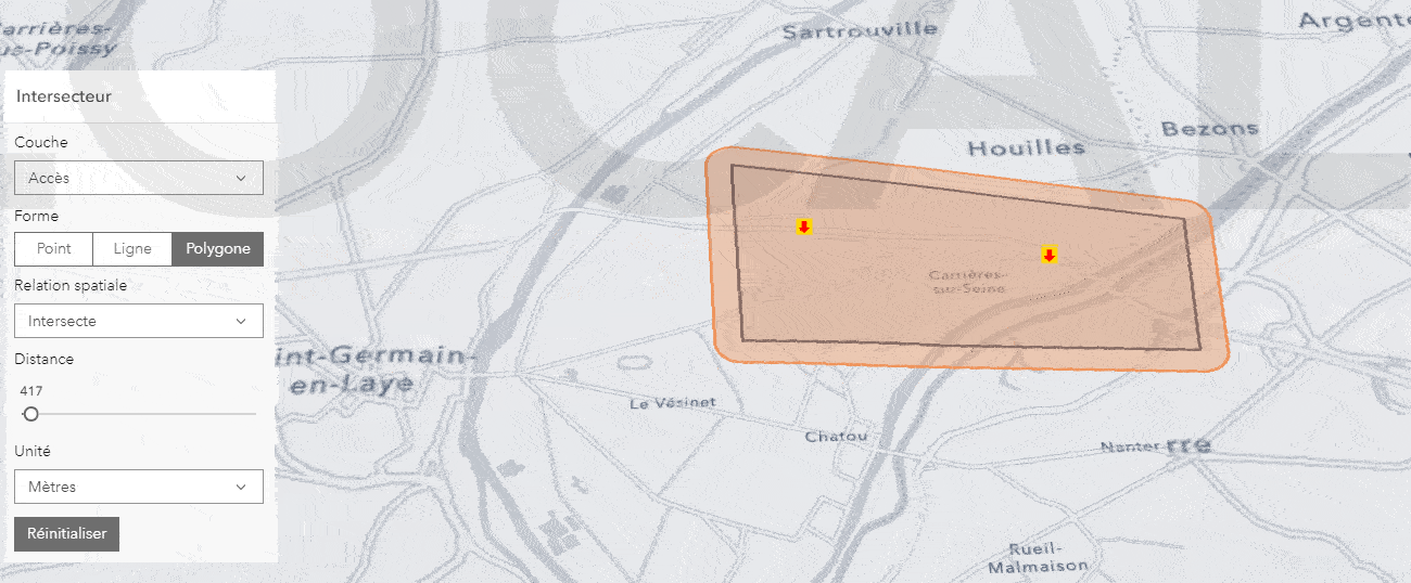

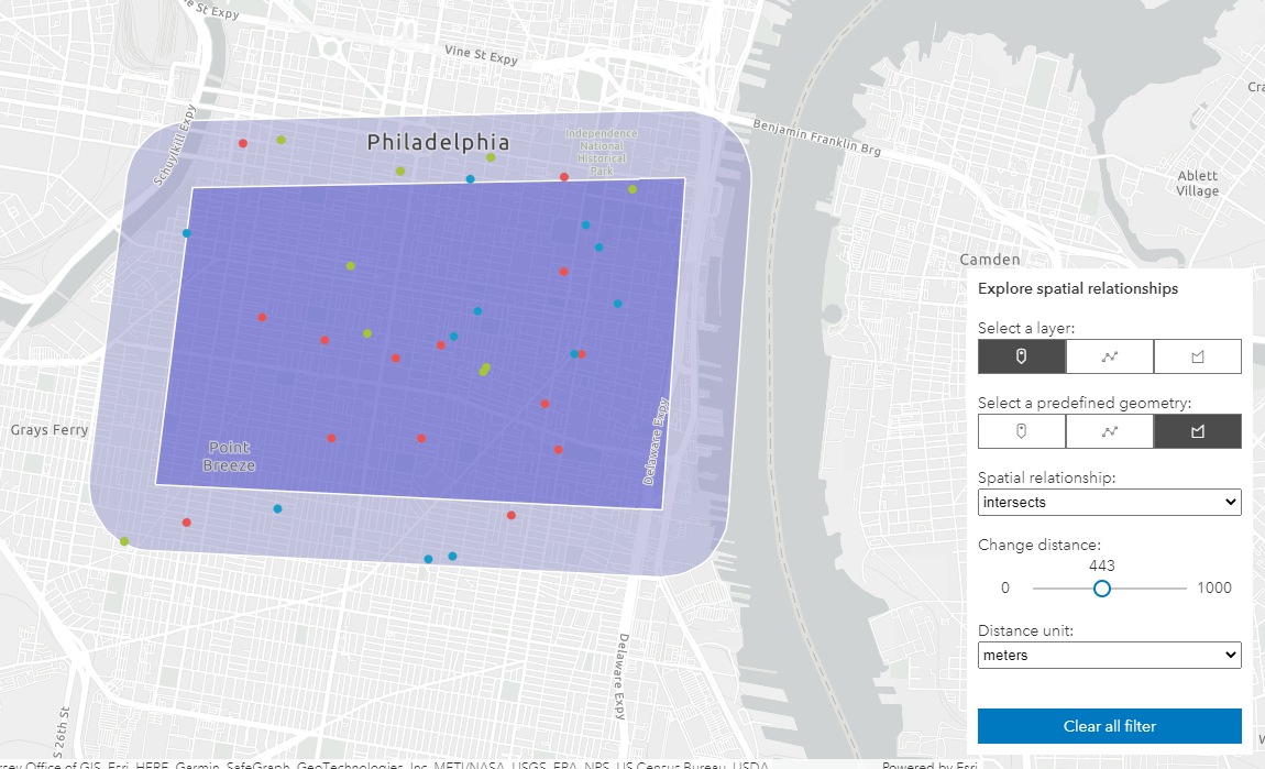

The issue I have is with the buffer. The example works fine
But when I try to replicate it, there is this strange gap between the visual of the geometry and the actual geometry used to filter the features:
I'm doing nothing more than the example do :

Do you have any ideas what would be the problem ?
I'm guessing maybe something wrong about a wkid ?
