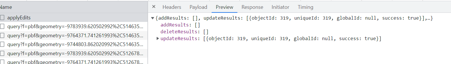

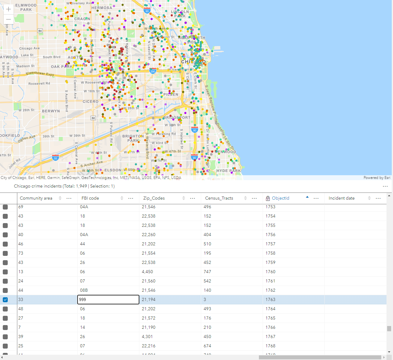

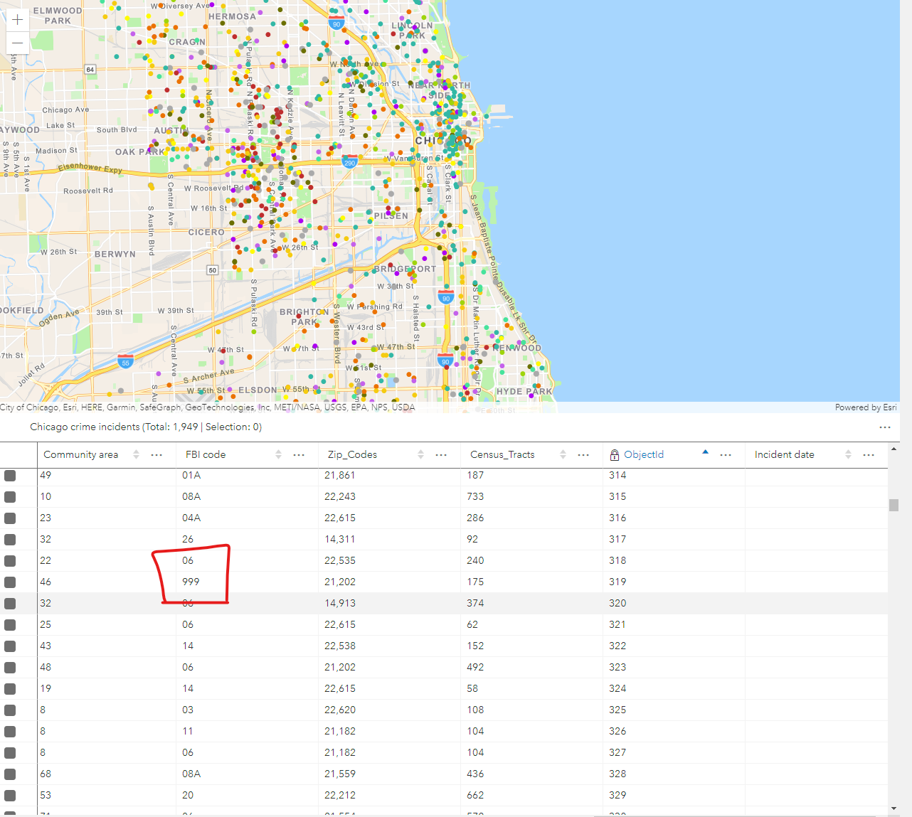

It seems when you are editing with a larger amount of rows, the "bottom" rows apply the incorrect applyEdits rest call. For instance, when I try to edit the FBI code shown in the screenshot, the row has an objectID of  1763 and when I look at the network request it applies the update to the row for objectID of 319.

Edit of 1763

We found this as well, it’s BUG-000154063. I think it will be fixed in 4.26.
