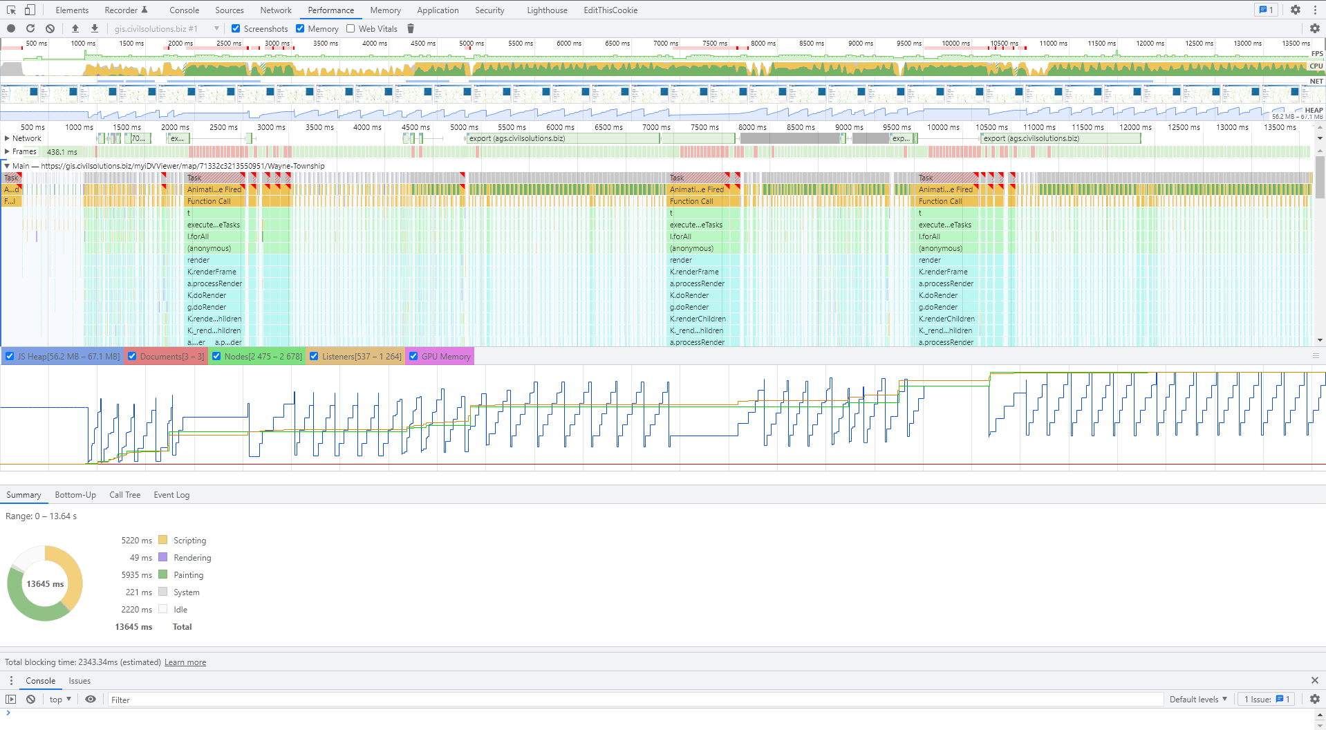

The site I have has about 100 layers, all coming from different map services. I'm adding the layers like so..
var layer = new MapImageLayer({
  url: "[map service url]",
  imageFormat: "png32",
  sublayers: [{
      id: "[id of the map service layer]"
     visible: false,
     source: {
         type: "map-layer",
        mapLayerId: "[id of the map service layer]"
layer.id = "[unique id number]"
mapLayers.push(layer);
Is there some type of limit on how many MapImageLayer I can load? It gets very slow just doing basic panning. I did the same thing in v 3.x and never had a performance issue.
Attached is a performance profile from Chrome Dev Tools. You will notice that ESRI's JS API is dropping frames when painting the map to the screen.
Any help would be appreciated.

We were able to reproduce the issue you reported where frames being dropped when panning a map over 100 map image layers. I will let you know once we have an update.

Hi @DonnyVelazquez, we have improved performance at 4x with MapImageLayer for the upcoming release (version 4.25). This enhancement will best be viewed using a browser that supports WebGL2.
