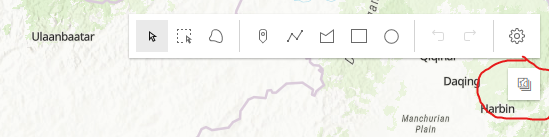

I want to add my own button into the sketch widget toolbar.
This forum post will create the button in a new div outside of the Sketch Widget.
With the code:

I'd really want to include that button alongside all of the other buttons - and still control what tools are available.
Is there a recommended ways to do this? Are there any articles?

The widget isn't extensible, so you can't add more buttons. You can use the SketchViewModel and build a custom component around that.
https://developers.arcgis.com/javascript/latest/api-reference/esri-widgets-Sketch-SketchViewModel.ht...
Depending what you want it to do though, you could have a container that wraps the Sketch widget and your custom button along side each other, so it looks like a new button, but when you click it, you can call methods on the Sketch widget or the layer, not sure what your button would do.
