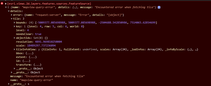

When I try to load a public Feature Layer hosted in ArcGIS using the JS library I get an error:
My code is basically what the documentation suggests doing. I am using ES Modules to load the map in an Angular 12 application. The following is a snippet of what i have tried(which is just what the documentation suggests):
    const webmap = new Map({
      basemap: 'arcgis-dark-gray'
    const view = new MapView({
      container: docuemnt.getElementById('container'),
      map: webmap,
      center: [-2.7319798957155292, 54.999668703716296],
      zoom: 4
    const layerView = new FeatureLayer({
        url: {{FeatureLayerURL}}
    webmap.add(layerView);

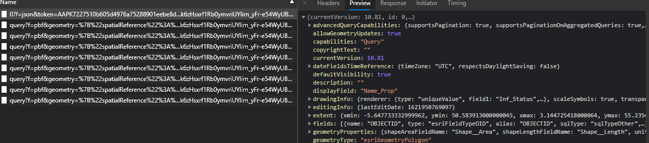

The Feature Layers shows correctly on the service definition and on the ArcGIS  Online Visualization tools.

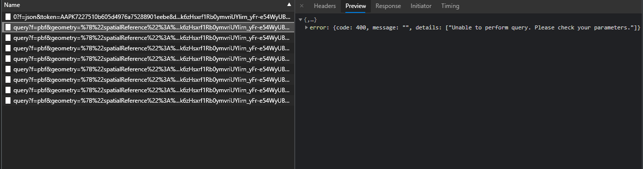

 What seems weird is that the first request to retrieve the layer ({{url}}/FeatureServer/0) seems to  work
But then it tries to query (I am not manually setting any queries so i'm lost)
Does anyone have any pointers as to how to fix it?
