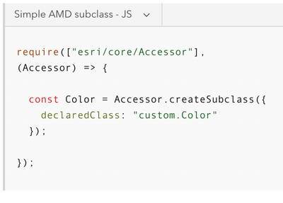

I just noticed you're using the "esri/" paths, so you must be using the AMD CDN.
In that case, I don't think you can use the 'extends', you need to use createSubclass.
The snippets here provide a dropdown to switch between TS and JS, and you can see what I mean.
https://developers.arcgis.com/javascript/latest/implementing-accessor/
I haven't built custom widgets in this pattern, so not entirely sure, but that might be the way to go.
I did update my ESM widget sample with your code and it does work, so I think it's the createSubclass you need.
https://github.com/odoe/jsapi-ts-esm-widget/blob/main/src/test-widget.tsx
