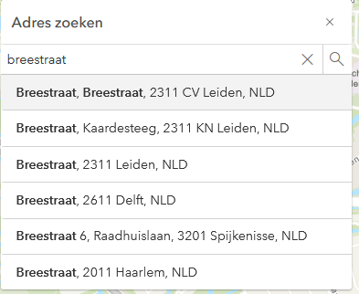

Good morning/afternoon/evening,
I’m working on (my first) map app, but am a bit stuck on a few things. I hope one of you would be so kind as to help me out.
I made a calcite panel containing a Search widget that is opened from an action bar in the same way as they do in the tutorial (https://developers.arcgis.com/calcite-design-system/tutorials/create-a-mapping-app/) for bookmarks, print, layerlist, etc.
It looks a bit strange though. The search widget is less wide than the panel. But more importantly, there is no space for suggestions below it (see screenshot “Search short panel 1”). So when you type a street name, you do not see any suggestions unless you scroll (see screenshot “Search short panel 2”).
Is there a way to make it update the height automatically or to just make it bigger? Or should I just not try to put this widget in a panel?
I’ve tried setting a min-height for the search-container, but that makes it behave weirder (see screeny “min-height set”).
It looks like this.

LeidavanHees
Hi Anna,
I didn't find a perfect solution, but did eventually end up with something I'm okay with:
I don't have much time to dive into it today. But I think this is the relevant code:
#search-container {
	position: fixed;
.esri-search {
    	inline-size: var(--calcite-shell-panel-width)!important;
	max-inline-size: var(--calcite-shell-panel-max-width)!important;
	min-inline-size: var(--calcite-shell-panel-min-width)!important;
	transition: max-block-size var(--calcite-animation-timing), max-inline-size var(--calcite-animation-timing)!important;
 	border-radius: 0px 0px 5px 5px !important;
	--calcite-ui-brand: none !important;
.esri-search__suggestions-menu {
	border-radius: 0px 0px 3px 3px !important;
.esri-search--show-suggestions .esri-search__suggestions-menu, .esri-search--sources .esri-search__sources-menu {
	border-top: solid 1px rgba(200,200,200) !important;
	margin: 0 0 0 0 !important;
Probably not all of it is relevant for you, like the colors and --calcite-ui-brand stuff. But I didn't have the time to sort it out today.
And not everything may even be needed to get it to work (I stopped fiddeling with it as soon as it worked).
Do let me know if it doesn't work. Maybe I didn't copy all the relevant bits. Good luck!

AnnaWilliams
Hello,
I know this is an old post, landed here looking for a solution to the same issue.  I made some minor CSS adjustments https://codepen.io/msamwill/pen/wvRGvzg and the width looks better.  I still have not solved the issue of the panel height dynamically adjusting based on the height of the search widget.  Did you ever solve it?
LeidavanHees
Hi Anna,
#search-container {
	position: fixed;
.esri-search {
AnnaWilliams
Thank you!  That is working for me too. 😀
LeidavanHees
Great! 🙂
AnnaWilliams
Did you add any JavaScript to handle view resizing?  If I change my panel size in JavaScript shellPanel.widthScale = "l" the width of the search widget does not adjust.
