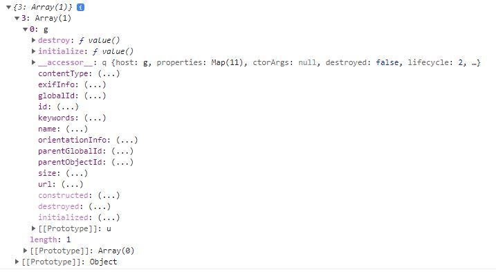

For better visibility, I changed the code to log the entire attachmentsByObjectId object.
// get all attachments for feature with objectId = 3
const oid = 3;
const attachmentsByObjectId = await layer.queryAttachments({
    objectIds: [oid]
console.log(attachmentsByObjectId);
Here is a screenshot of what's logged in the dev console in chrome:
What I should be seeing is {3: Array(2)}
