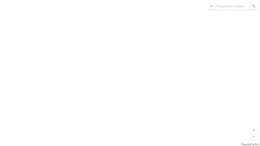

Fox71
Noah,
Sorry for the delay, I had to move my test on a new page. You can look at https://www.usu.edu/test/map/
For the test, search for "huntsman hall" (building). Then search for "school of accountancy". That marker has the same coordinates and shows up behind the other one.
UndralBatsukh
Hi there,
So I looked your test app. I'd suggest adding your search results to a different layer and order the features in that layer by their ObjectIds in descending order to ensure that the latest feature is always displayed over other features. You can order the features by setting orderBy property on the layer.
I created this simple codepen app to show how this would work: https://codepen.io/U_B_U/pen/XWzbJbq
In this app, I am creating a client-side FeatureLayer as shown below. Notice that I am setting the orderBy parameter to order features by their ObjectIds in descending order.
let searchLayer;
view.whenLayerView(jsonLayer).then(() =>{
  searchLayer = new FeatureLayer({
    source: [],
    copyright: "USU",
    popupTemplate: jsonLayertemplate,
    fields: jsonLayer.fields,
    renderer: jsonLayerRenderer,
    orderBy: {
      field: "OBJECTID",
      order: "descending"
    objectIdField: "OBJECTID",
    geometryType: "point",
  map.add(searchLayer);
Then when the search is completed, you add the search result to this layer as shown below.
searchWidget.on('select-result',function(event){
  layer = event.result.feature.layer;
  const adds = {
    addFeatures: [event.result.feature]
  searchLayer.applyEdits(adds);
I noticed that UniqueValueRenderer you are assigning to your GeoJSONLayer is incomplete. You need to make sure all unique values are included in the renderer. Otherwise, orderBy won't work properly. For example, I had to add general type in the renderer like the following:
  value: "general",
  symbol: {
    type: "picture-marker",
    url: 'https://webdev.usu.edu/map2/images/icons/interest.png',
    width: '32px',
    height: '37px'
  value: "general building",
  symbol: {
    width: '32px',
    height: '37px'
Hope this helps,

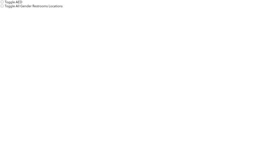

Fox71
Undral,
Fist, many thanks to you for taking the time to build that example, really! I am very new to GIS and not an expert in JS, so there is some struggle....
I was able to get it to work. Following your example, I tried to apply the same concept to a bunch of toggle filters. They also don't stack up correctly in the order they are triggered.
Something I noticed too is that if I click a marker displayed from a search results and if that marker is over a maker triggered from the toggle tools, the opening popup is from that triggered marker. I wonder if the layers needs reorder based on the last user action (search or toggle button).
I rebuilt an example with your update and a couple toggle buttons at https://codepen.io/Fox71/pen/podJEVL?editors=1000. A good test is to trigger the restroom toggle and search for "HH" in the search.
I actually tried to use the searchLayer for the toggle buttons by adding an expression. While it can take an expression, I don't think the geometryType (point) works since the toggle buttons can return many points. Just my assumption. Let me know what you think if you can.
Thanks again!
Ben
