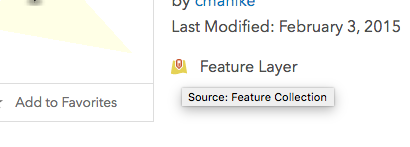

For 3.xx versions of the JS API, the PortalUser class has the method, getItem(itemId).  This  method enables a user to get the displayName and type and iconUrl of an item.
What is the equivalent method in the 4.0 version?  I see fetchItems(), but that's it.
Ultimately, I am trying to get the displayName and iconUrl property of the item, not just the item's type.
For example, the item here has a displayName Feature Layer, the type is Feature Collection, and the iconUrl is here.
Screenshot from AGOL showing displayName, type, and icon from iconUrl of item:

Looks like those two properties where calculated in 3.x.  Looks like both properties were calculated by checking for various typeKeywords. Is there a specific reason why you need to use those properties in an app?

Hi Kelly ,  we use them in the Living Atlas and the Living Atlas Contributor application.  I was using the displayName and the iconUrl to mimic what AGOL does (see image below)
