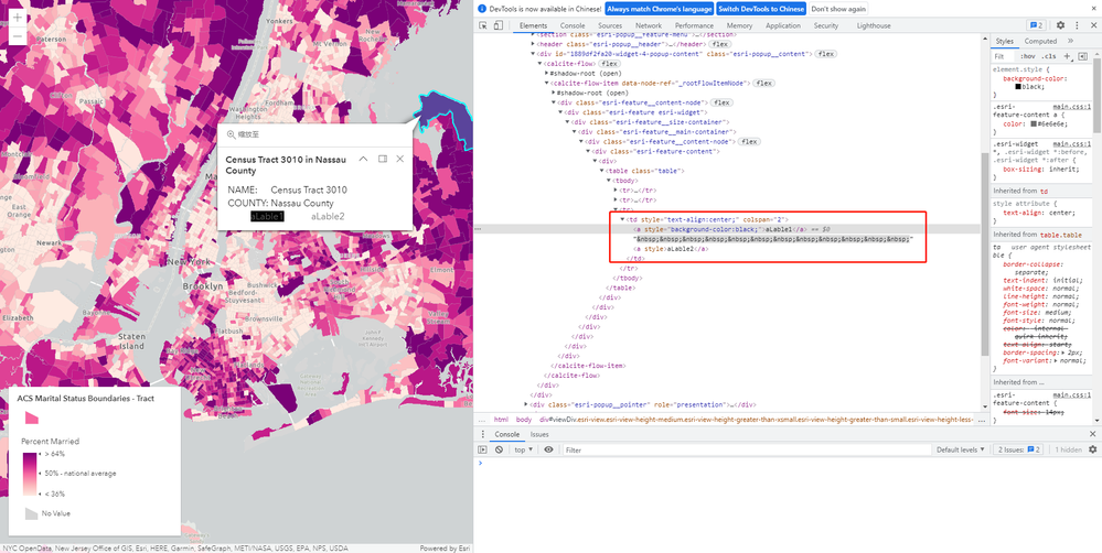

Higher version(4.26) Arcgis api for js miss part of attributes like style or "onclick" event.

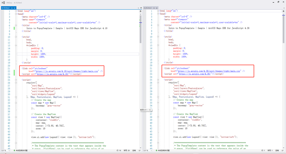

There are two identical fileexcept for the version of Arcgis api for js,one is 4.26,the other is 4.10.

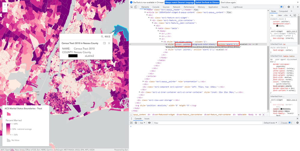

微信图片_20230609101811.pngStrangely, higher version file may lose some attributes.
Has anyone encountered this situation or known the reasons and solutions?
Here is the code and change the version4.10 to 4.26 to get two files:

Adding some HTML tags directly in the content will be sanitized, like links or click events. You can work around this in your app a couple of ways, like returning a function in the content or using CustomContent.
https://www.esri.com/arcgis-blog/products/js-api-arcgis/mapping/using-html-with-popups-in-the-arcgis...
https://developers.arcgis.com/javascript/latest/sample-code/popup-customcontent/
https://odoe.net/blog/custom-popup-content
